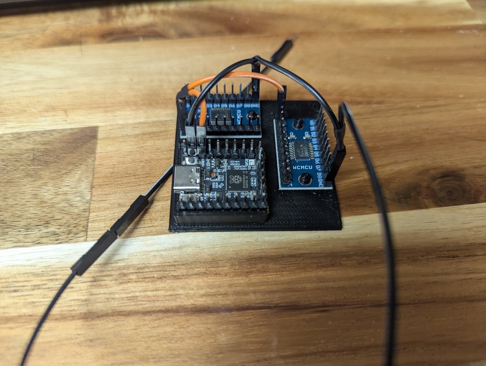

I designed/3d printed a small platform for a micro RP2350 and two TXS0108E’s today. Going to try out blueTag with this while I’m waiting for the BP6 to be shipped. I’m a little OCD about my jumper wires so I’m custom making all of them, so far only got the 3v3 and gnd done. It’s a pain but looks nice and eliminates some noise.
