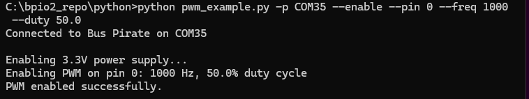

I’m working towards getting HDUART mode working, and the best test we have for that is the SIM/bank IC card reader. This needs a PWM, so step one is supporting PWM from bpio2.
Still experimental, but I updated the flatbuffers schema, tooling, and the python client. It seems to work fine. Next I’ll finish up the HDUART bpio mode and update all the docs.
