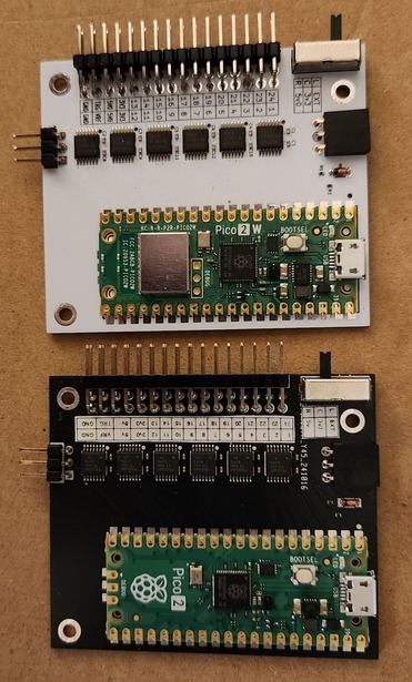

To your comment about Dr GusmanB throwing in the towel… there is hope, and I am holding the physical evidence! It’s ALIVE!
