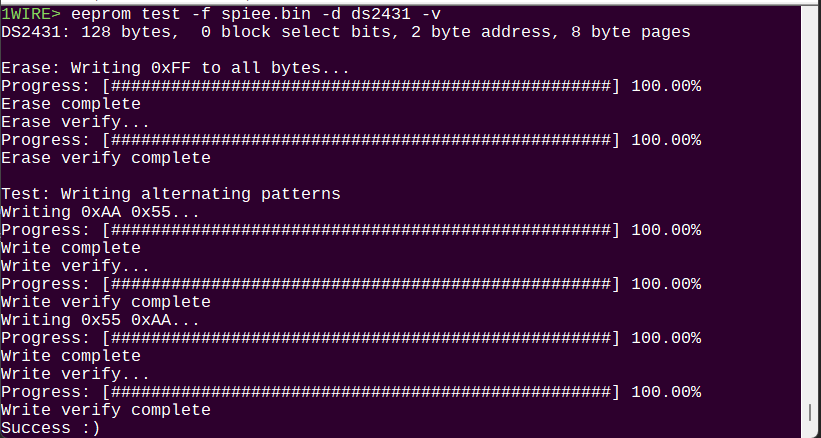

The new eeprom framework should make it pretty easy to add support for DS2431 1-wire eeproms, which I have here on a breadboard.

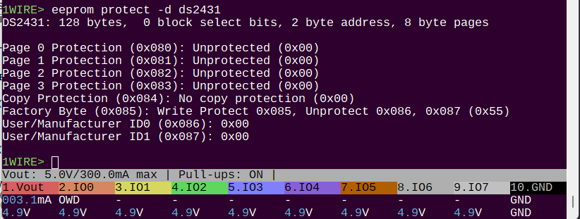

Looks good! trying to figure out if it’s worth dealing with the write protection bits.
Analyzing but not manipulating the write protection control blocks.
1-Wire EEPROM command is now in the main firmware and documentation.
