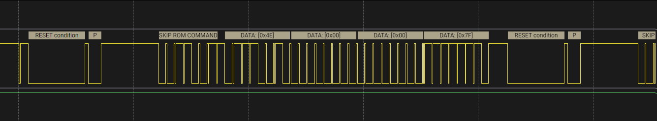

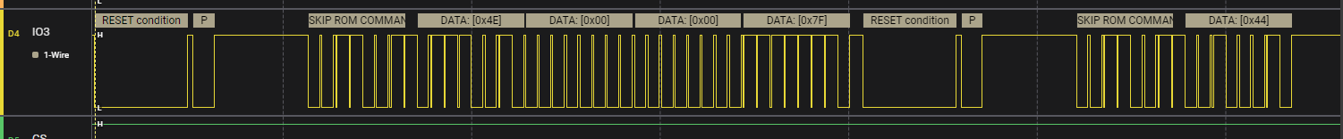

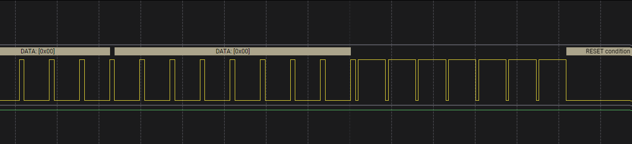

I added a 1-Wire PIO-based example from github to the firmware, and modified it to work through the Bus Pirate’s buffer. It’s kind of working, there’s a transmission glitch in like 90% of the tests. I’m tracking this down now.
1-Wire is kind of a monster project because there’s no end of helpful things to make it less of a pain in the neck to work with.
The reset command was cutting off the final bit of the transmit. I added a wait for idle and it seems solid now.
