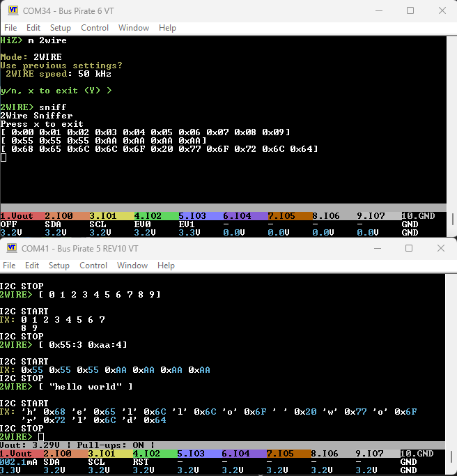

sniff command in 2WIRE mode logs I2C-like protocols that don’t have an ACK/NAK bit. This includes SLE4442 IC cards and TM1640 LED drivers, among others.

2WIRE format
| Start Bit | Data Bits (8) | Stop Bit |
| [ | 0xA5 | ] |
- Start Bit ([): Indicates the beginning of an 2WIRE transaction.
- Data Bits (8): The 8-bit data being transmitted (e.g., 0xA5, 0x3C).
- Stop Bit (]): Indicates the end of an 2WIRE transaction.
The only difference is the missing ACK/NAK bit.
