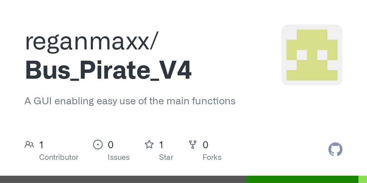

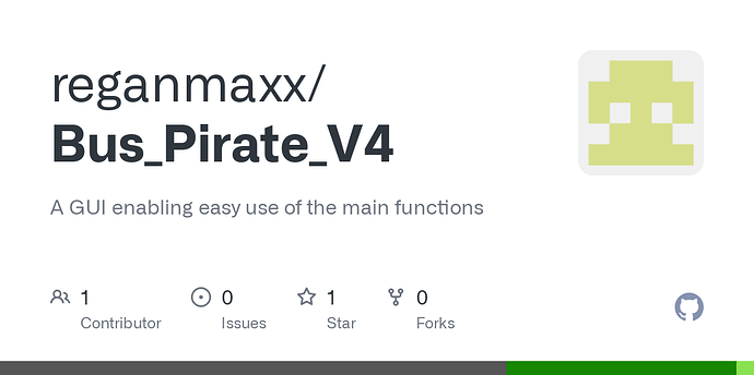

There’s one for V4.
Nice find! Too bad there’s no screenshot, I wonder what all it did.

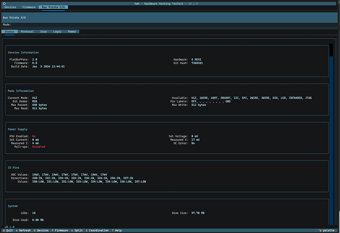

I’m working on a unified tool that’s a python TUI. My biggest frustration was always how there wasn’t a lot of crossover in tooling. I want to try and bring basic functionality for any of the tools that support python. I’m still very green in this space though, so any guidance is appreciated.
You likely want to look at controlling the BusPirate via BPIO2 interface.
Because it’s based on flatbuffers, it has direct availability in many languages, including python (and C#, and …)
I am using BPIO2. We are discussing adding support for UART and glitching in a separate thread since SPI and I2C are the only supported protocols at the moment. It’s going good so far.
