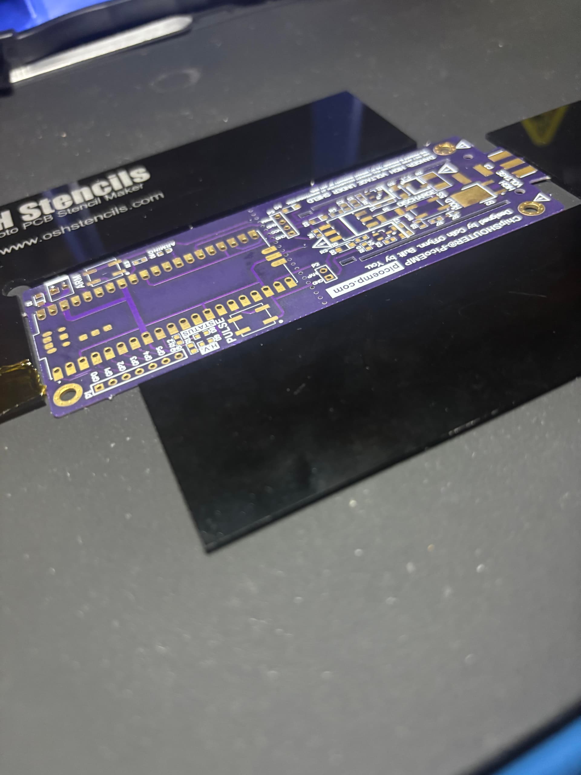

dont worry mate, i am right behind you building this pico-emp, and my so bought me a chipwhisperer for getting older by one year.

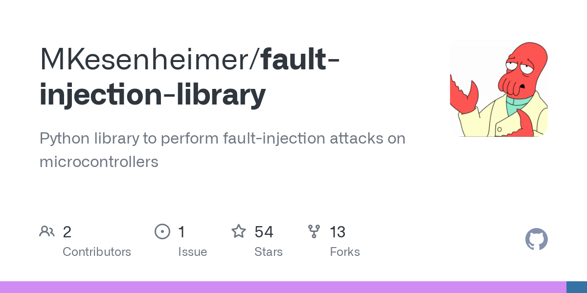

Not sure if these were mentioned, but I happen to run across a project for voltage glitch tool based on the Pico:
MKesenheimer Blog on PicoGlitcher
https://mkesenheimer.github.io/blog/pico-glitcher-pcb.html
Library used with the PicoGlitcher
There is a subreddit r/hardwarehacking that also mentions this, but can’t post link due to 2 link limit.
