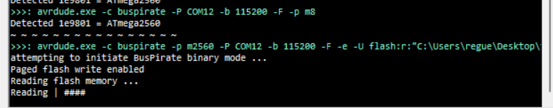

AVRDUDESS Flash dump error

I just posted in the dude repo: Add support to the Bus Pirate for larger flash chips · Issue #2043 · avrdudes/avrdude · GitHub
Wow, you guys are amazing :slight_smile: Would it be possible to post a version of the firmware with the changes applied so I could also test?
@chickendipper this is the version
With @mbrugman 's solution and @stefanrueger ’s confirmation and comments, we have everything we need to support families with large chips.
@mbrugman , can you make your PR to the Bus Pirate repo and tag me, please? It would just be a matter of adding the logic @stefanrueger mentioned. If you have any questions, run into any issues, or need help with anything, just let me know.

I just finished and made a PR (not to be merged yet). @Dreg, can you test on your ATMega128 board?

Right now I can only test it on:
ATmega32U4
ATmega328
ATmega2560
I tested on a 328, if you test on 2560 that will show the extended high byte write is working. I forgot that you had a 256, not a 128
The ATmega128 still hasn’t arrived at my home:(
a 128 would be great for full confirmation, but what I’m looking to see is that my logic of reading the signature to set the “needs high byte” logic is working.
