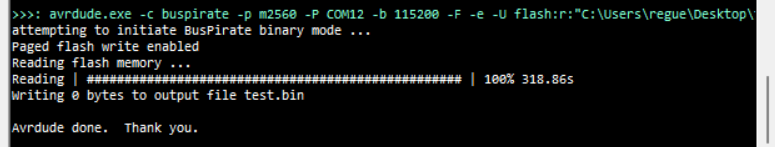

@mbrugman dont works :frowning:

@dreg - did you expect the flash on this part to be completely blank (every byte 0xff)?
Sigh, the log doesn’t really show any errors on the BP side. I added a couple of more debug statements; the first to see if the extended high byte write bit is still set when it gets to the actual reading, and another just to verify that the read is doing what I think it’s doing.

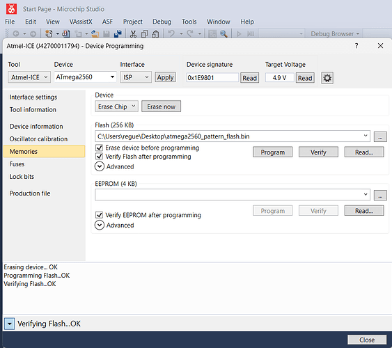

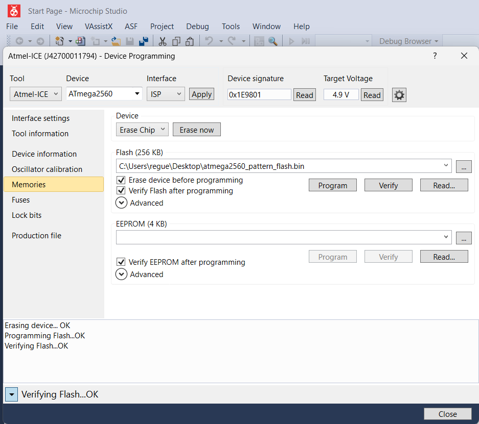

The flash is fully filled from start to end with a pattern to detect any data corruption.

I just reflashed the flash pattern and everything is correct. Let me know when you want me to test more things.
