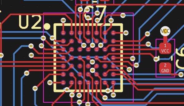

NOTE: This is just to help me validate my understanding … not actually asking to change anything!
What about having VIN flow from both edges (vias from topside make this easy), and keeping the GND plane connected at the centerline? Also, with vias added at outer edge for both VIN and GND from the top side?
Did I understand correctly that this would effectively reduce the worst-case return path by half?
Non-selected designs...
I also thought about branching the VIN lines to the nearest edge. I made a nice “X” pattern. Many reasons not to pursue that option, including:
  • Layout of the board would be annoyingly manual vs. simple copy/paste at offsets, due to the need to rotate based on which edge was closest.
  • silkscreen (and user usage) is much more comprehensible on the column pattern
  • Would not reduce worst-case return path length very much
