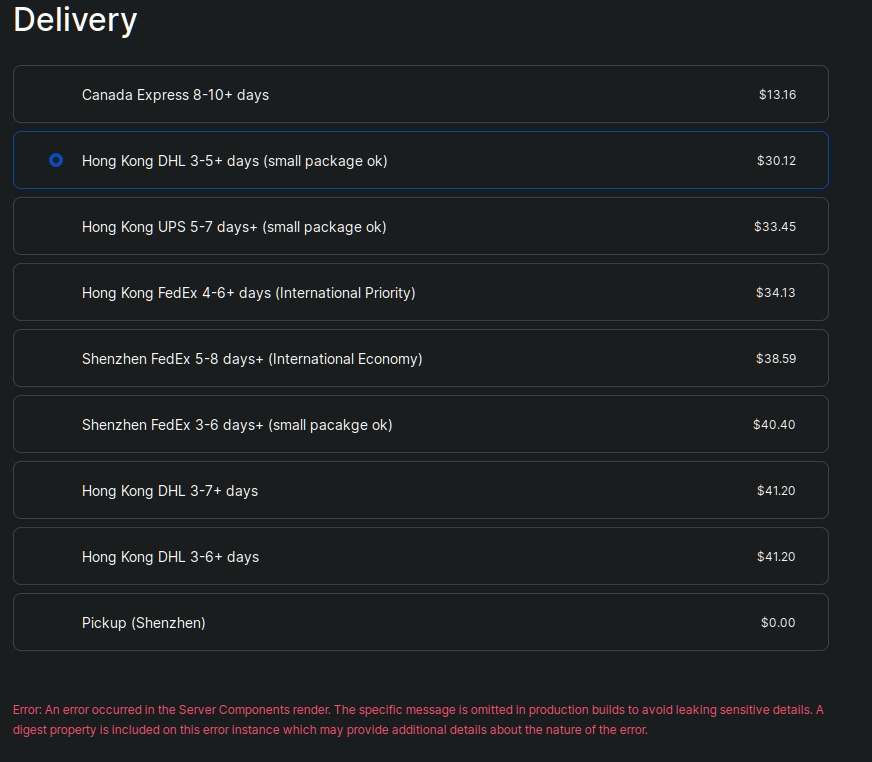

EDIT: When I try and pick the Canada express shipping option, I get this cryptic error:

Grrrrr, I’m so sorry. The new shop was supposed to be all the latest and greatest (MedusaJS) but it’s been nothing but a lemon and a money pit.
There is a known bug if you are logged in then there will be checkout errors. So log out if you are logged in.
If that isn’t it, I’m sorry, I can’t do much more at this point. I don’t know all the web technologies well enough to push a fix myself. We’re going to switch to a system I am capable of hacking on soon-ish.
An alternate option is to buy on DirtyPCBs, then open a support ticket for the express line shipping. They can refund any difference*.
*Probably good to mention that the shipping price will probably be different than in your screenshot. Of the many issues with the new shop, one is that I haven’t been able to update the shipping rate tables for a couple months…
