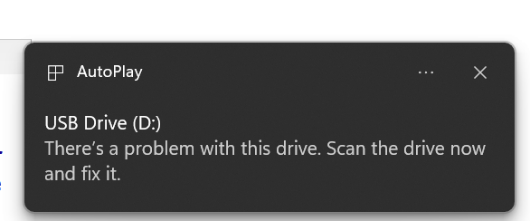

Just picked up a BP5 rev10 and updated to latest firmware (the rev10 firmware from ci-buspirate-main-cfe5e7c). I’m running Windows 11 24H2 (Build 26100.3775).
Every time I plug the BP5 in, OR change a configuration that requires it to detach and re-attach itself (like going into bootloader mode or disconnecting from the terminal), Windows tells me that there’s a problem with the drive:
If going to bootloader mode it says there’s a problem with the RPI-RP2 disk.
It’s worth noting in both instances the drives and mounts are working completely fine, and Explorer lets me use it just fine (and the firmware upgrade I did initially was a success).
Out of curiosity I tried to run the scan and fix, it said it fixed the drive - but upon plugging back in again it decided there was a problem with the disk again. So much for “fixing” the drive and clearing the dirty bit… windows moment lol
Any ideas what this could be/is anyone also seeing this behaviour?

After a bit of playing around, yes, Windows is setting the dirty bit when the drive is surprise-removed.
cmd>fsutil dirty query D:
Volume - D: is Dirty
cmd>chkdsk D: /F
The type of the file system is FAT.
Chkdsk cannot run because the volume is in use by another
process.  Chkdsk may run if this volume is dismounted first.
ALL OPENED HANDLES TO THIS VOLUME WOULD THEN BE INVALID.
Would you like to force a dismount on this volume? (Y/N) y
Volume dismounted.  All opened handles to this volume are now invalid.
Volume Serial Number is 5021-0000
Windows is verifying files and folders...
\System Volume Information\WPSettings.dat is cross-linked on allocation unit 3.
Cross link resolved by copying.
File and folder verification is complete.
Windows has made corrections to the file system.
No further action is required.
   97,681,408 bytes total disk space.
        8,192 bytes in 1 hidden files.
       32,768 bytes in 4 files.
   97,640,448 bytes available on disk.
        8,192 bytes in each allocation unit.
       11,924 total allocation units on disk.
       11,919 allocation units available on disk.
Volume - D: is NOT Dirty
At that point if I disconnect and reconnect the device, it wouldn’t give me a notification again. Although that of course changes as soon as another surprise-remove happens. Although as you said, it’s an unfortunate side effect really and the BP5 firmware is doing exactly what it needs to do to prevent corruption. Windows is also doing exactly as it intends to do, so it’s perhaps not really something that’s “fixable”.
