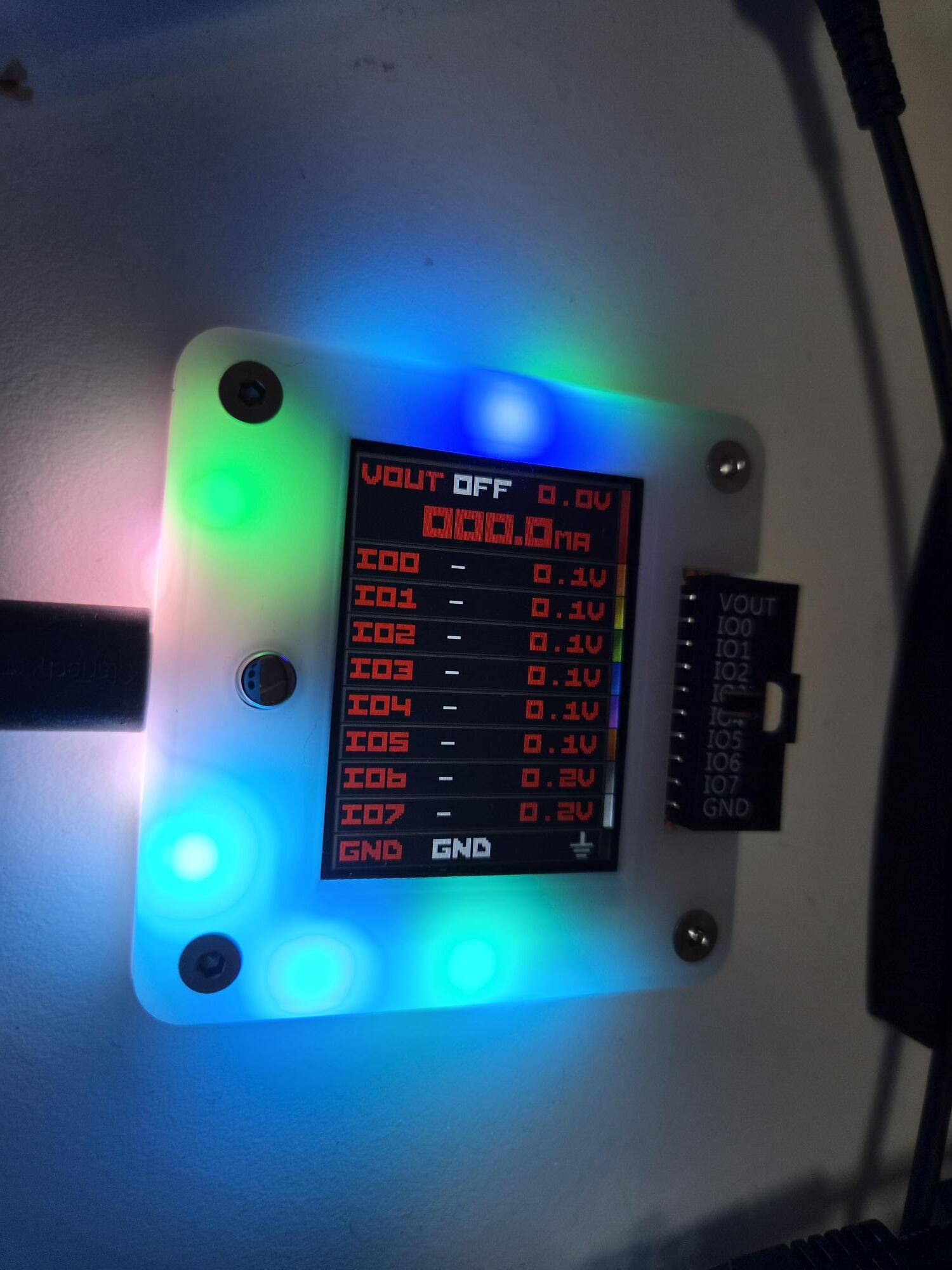

Originally the LEDs were animating (breathing/changing brightness and colour). After disabling the effect they appear to stop animating, but the LED ring remains fully illuminated and does not turn off.
The unit also becomes very warm, and at times feels hot enough that I am uncomfortable touching the enclosure. I initially suspected a configuration issue, but setting the colour to 0x000000 and updating to the latest firmware did not change the behaviour.

I’ve attached a photo showing the current LED behaviour.
