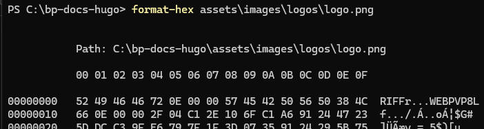

Sorry for the delay, a bit scattered this week. Based on the error, I believe it is because logo.png was secretly WEBP (first four bytes RIFF). I replaced it with a proper PNG and did a scan for any other assets with the same issue. I pushed the fix.

Technically, RIFF @ 0x0000 is just the ID of the container type (or more accurately, the ID of the chunk).
It could be a gazillion file formats, such as many .WAV files, just by the RIFF. It’s the WEBPVP8 starting at 0x0008 that makes this a WebP image.
Decoding the file format...
RIFF is an ages-old specification Microsoft made to define the .wav file format. The indication of the format of the chunk is at offset 0x0008, which here clearly indicates the file is of type WEBP.
The next three bytes VP8 @ 0x000c are also required for a WebP container, and indicate the main WebP image chunk. The L @ 0x000Findicates this chunk uses lossless compression (would be ` aka 0x20 if lossy compression).
The container’s length field @ 0x0004 show a total file length of 0x0E72 (add offset + field == total file size of 0x0E7A).
The WebP image chunk @ offset 0x0010 gives an additional length of 0x0E66, and thus a next chunk (if any) would start at 0x0E7A.
That’s the file size, so this RIFF container only had a single chunk, which was the lossless WebP image format.
