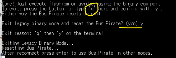

I think it should be possible to a new escape command. I’m not familiar with that code, but I will have a look and see if I can add an easy exit point.
Done! @bz2 Sorry it took me so long to get this done. I’m active on the forum again now. It’s included in this PR with a ton of improvements. Once @ian merges it, you’ll be able to use it.
