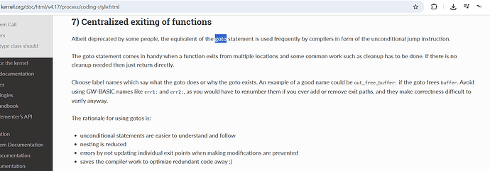

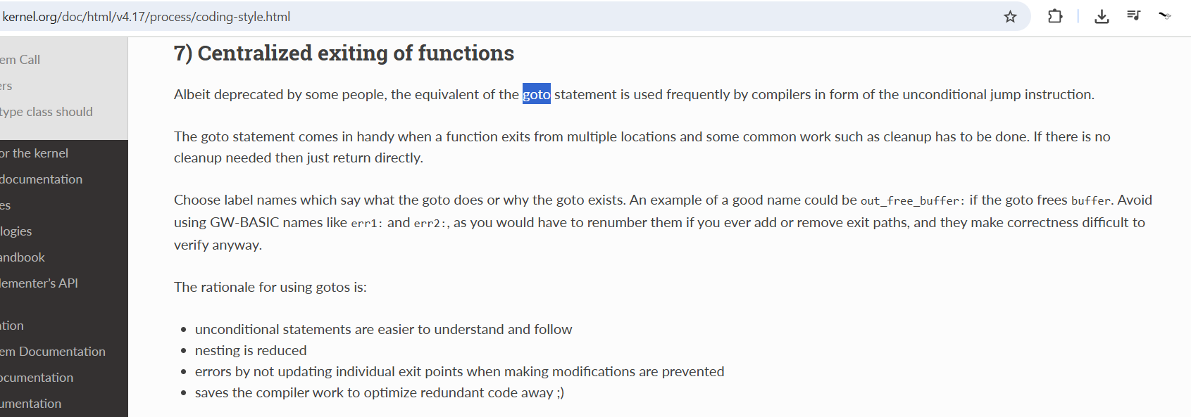

I’m reading “Linux Device Drivers, 3rd Edition” and this paragraph reminded me of this topic:
Error recovery is sometimes best handled with the goto statement. We normally hate to use goto, but in our opinion, this is one situation where it is useful. Careful use of goto in error situations can eliminate a great deal of complicated, highly-indented, “structured” logic. Thus, in the kernel, goto is often used as shown here to deal with errors.
Of course, kernel is using C (maybe some stuff got migrated to Rust? Not sure). But still, it was fun to see this pop up again. :smiley:
