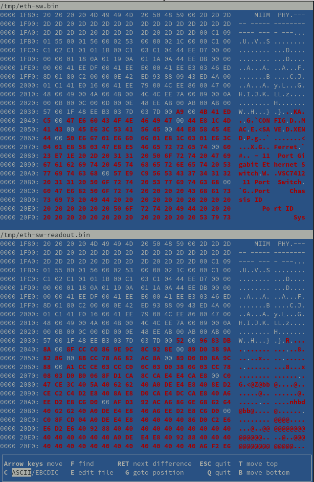

Flash command writes random junk data to SPI-NOR. Verification fails and one can spot blocks of junk data in read-out Flashrom via Buspirate5 binary mode flashes fine.

Sorry, there was no reason to blame. The issue was due to cable length and absense of shield. After I shielded the flashing TagConnect cable with copper tape, all went smoothly.

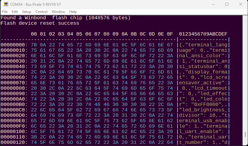

Because of your query I update the flash command with a new dump action to show the contents of the chip :slight_smile:
