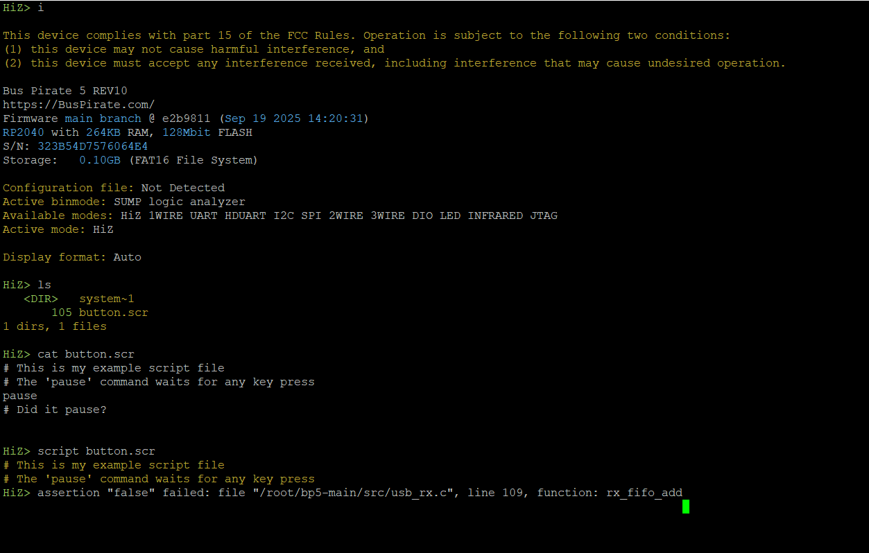

Scripts can not run:
Error: assertion “false” failed: file “/root/bp5-main/src/usb_rx.c”, line 109, function: rx_fifo_add
FW version: main branch @ e2b9811 (Sep 19 2025 14:20:31)
I started with a format flash and reflashing the FW. The issue appeared regardless.
I also tried with a firmware from eariler this year (f935018) the issue is similar. The difference is just in the line number (f935018: usb_rx.c, line 134)
To reproduce:
  • attach to computer
  • create script file with example content and save it
  • open serial port
  • run script file
Issue opened by: mitle

Ah, I see Henry has already been here: // BUGBUG -- breaks FIFO queue only being added to by Core1
Thank you so much for the bug report. It seems this is a known bug, there is already a comment in the code.
I’m going to need to find an alternate entry point for injecting the script. I will update in the forum and reply here when I have a solution.

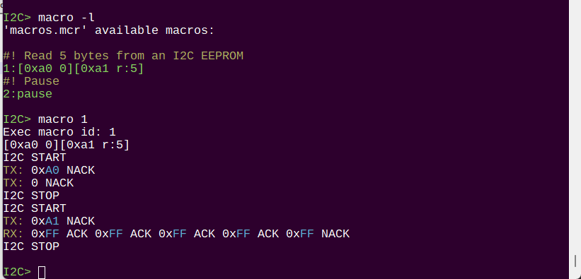

All the scripting stuff is working a lot better now, and I’ve updated the documentation.
Button is fixed and documentation added.
I removed the tutorial command which was just an alias of the script command with specific options. Having two version resulted in nether being well maintained/documented. I’m considering a rework of the CLI flags so that a tutorial like behavior is the default. I need to think on this a bit.
Doing a refresh of the macro command as well, will update those docs now.
