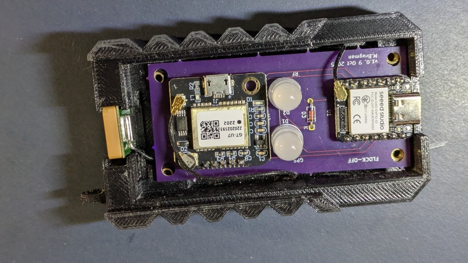

Latest project, sharing for fun
Just wanted to share my latest non-Bus Pirate related project - a surveillance sniffer. Nothing really dramatically new, but just fun. There’s an ESP32S3 for WiFi and BTLE sniffing and a GPS module for location. Just finished the first pass at the 3D printed case and assembly - I feel like it’s an actual product, haha.
Currently using it for wardriving. Once I have identifiers for surveillance things set, it’ll do flashy lights when those things are nearby. Plan on looking for WiFi names, MAC addresses, BTLE MAC addresses, 16-bit BTLE service UUIDs and anything else.
Github with details is at GitHub - mbrugman67/FlockOff: Wardriving WiFi/Bluetooth LE device detection

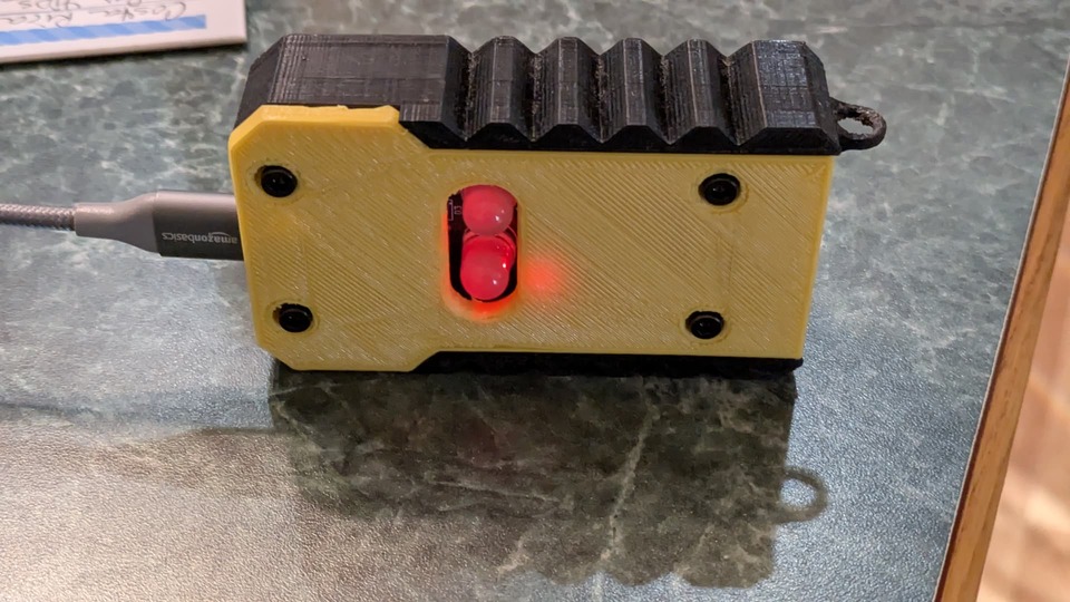

Really nice work on the case. It does look very professional!
Thanks! I spent a lot more time than I normally would. Doesn’t look as professional up close, haha.
I think the developer is more interested in selling the hardware on their Tindie shop. That’s perfectly fine; there’s room for everyone in the hobbyist tent :slightly_smiling_face:
A 3D printed case, especially with the design details you added, is always such a nice touch. I think you get used to the 3D printed aesthetic too. At first I found it a bit weird, but now it seems totally normal.

For the record, I bought a set of PCB’s from him, but the hardware is trivial to built on a proto-board, so I built a second one.
The PCBs are kind of funky and cool - I think he did a nice job on them, but yeah; the hardware is pretty trival.

The truth is, I’ve always been terribly lazy about doing 3D printing for my personal projects :rofl:
