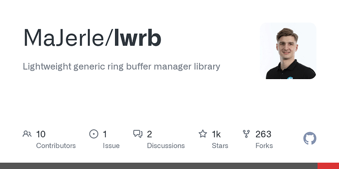

I’ve been looking at alternatives and this looks pretty good:
It has the ability to handle arrays, instead of the single bytes we currently feed the queue.
