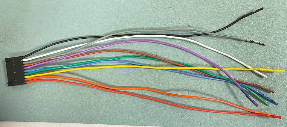

Probe cable v2 with full color silicone wire
The silicone coated wire people have upped their game and have actually not ugly colors of wire now. We could have a fully color coded probe cable.
Previously many colors were kind of an ugly pastel Easter theme situation (blue, green, brown, etc).
The catch is we have to buy MOQ of the 7 colors we don’t already use, and they don’t sell cuts or samples. Kind of a gamble.

We are slow sometimes, but we get there. Samples of color coded probe cables arrived this morning.
I have to say, I am extremely pleased with the color of the wire and the match with the shrink tube labels. It’s been a years long quest to find not-ugly silicone coated wire, and today we’ve done it!
That’s a good thing, because we had to buy MOQ (a reel) of all the colors to make a sample :slight_smile:

That is beautiful!

Just throwing out a a suggestion to consider, because it’s time-sensitive: This would have to be accepted or rejected BEFORE production runs of the full color silicon wire probe cable and full-color silicon wire auxilliary cables.
TLDR: Shift the brown wire so it’s next to the black wire. Why? much closer alignment of relative order vs. resistor chart.
Here’s the full change list:
Conn v1 v2 Ω
Vcc Red Red 2
IO0 Orange Orange 3
IO1 Yellow Yellow 4
IO2 Green Green 5
IO3 Blue Blue 6
IO4 Violet Violet 7
IO5 Brown Grey 1 → 8
IO6 Grey White 8 → 9
IO7 White Brown 9 → 1
GND Black Black 0
Small change … But maybe the benefit isn’t worth any potential confusion. Depends on how many grey-wire sets were sold?
Putting it out here so those better equipped to decide can weigh in.
