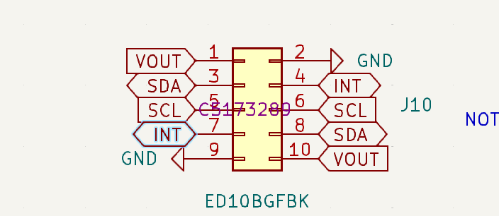

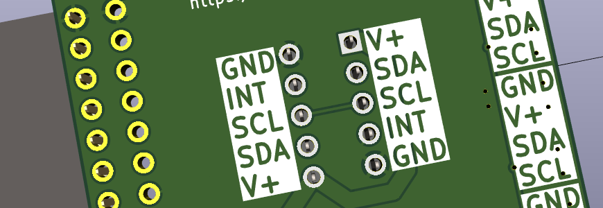

Actually, sorry, it was correct. Signal on the left, ground on the right. :upside_down_face:
At the risk of being cheeky, would it be worth connecting the currently NC pin in the Pimoroni connector to an IO pin? Some of their breakouts have an interrupt line on that pin.
Edit, eg: RGB Encoder Breakout
Thank you! Excellent suggestion!
Done!

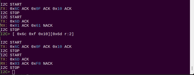

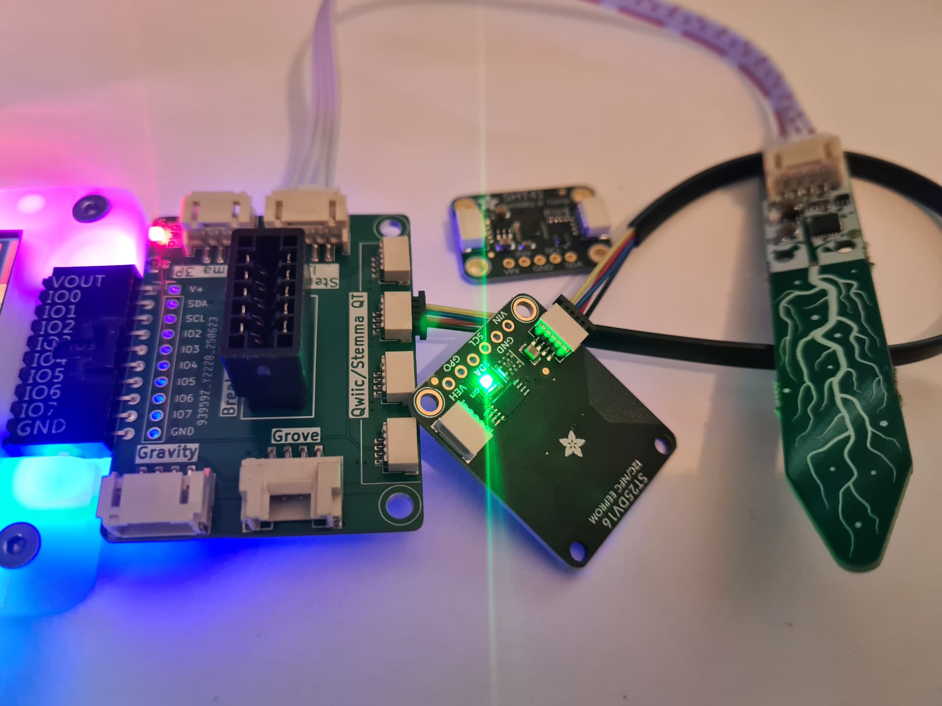

STEMMA I2C (2.0mm) connected to Adafruit I2C soil moisture sensor. First reading (0x01 0x61) is baseline, the next (0x3 0xf8) reading is while I touch the sensor (it’s capacitive touch based).

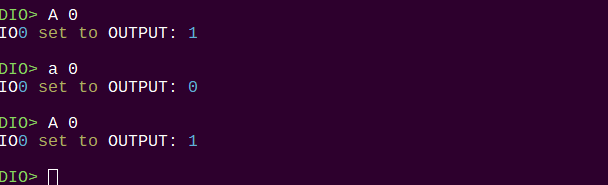

Testing Adafruit Stemma 3P (2.0mm) motor/mosfet driver. When powered the ON LED lights. When signal pin is high, SIG LED lights. Looks good too.

I picked up an SHT41 Temperature and Humidity sensor. We have a walk through for this one, and a sht4x command in I2C mode to read it automatically.
Spotted a ST25DV16 breakout, which is a programmable NFC tag with I2C interface. Don’t know a lot about this one yet, but it seems super cool. I’ll probably have to do a demo of it at some point.
Both boards work great, the voltage high/low levels look good at 3.3 and 5volts.

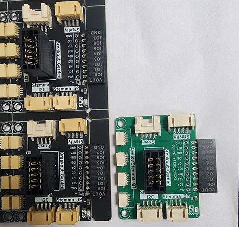

Unfortunately the assembler roasted the connectors. The first pass through the reflow oven didn’t melt all the solder, so they cranked up the temperature and ran them again.
We need to check with the supplier and assembler to see how to prevent this on a replacement batch.

OK, the connectors got baked at a temperature beyond their rating. I can see the color change on at least the Gravity and Stemma variants as evidence. I don’t see any change in the shape (from the picture).
Q: Is this strictly a cosmetic issue, or are they not salable? (e.g., would that higher temp make the plastic brittle?)
Not sure yet. We use the same vendor for the 9p sh connector on the bus pirate, it has never discolored.
PCBA baked it twice which always browns the previously baked stuff. So that is a factor as well.
Some parts also need a prebake to chase out anything that might discolor the plastic during reflow. That’s what the DDR5 socket vendors said. We have previous experience with this though.
They can be sold, I don’t think the shape is impacted but we want to get you a properly assembled board.
