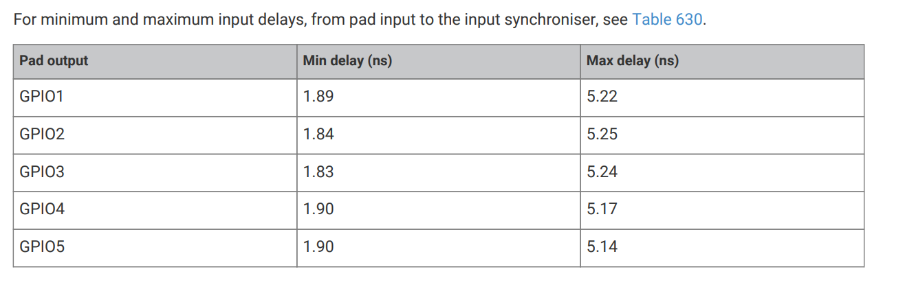

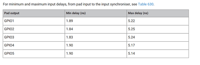

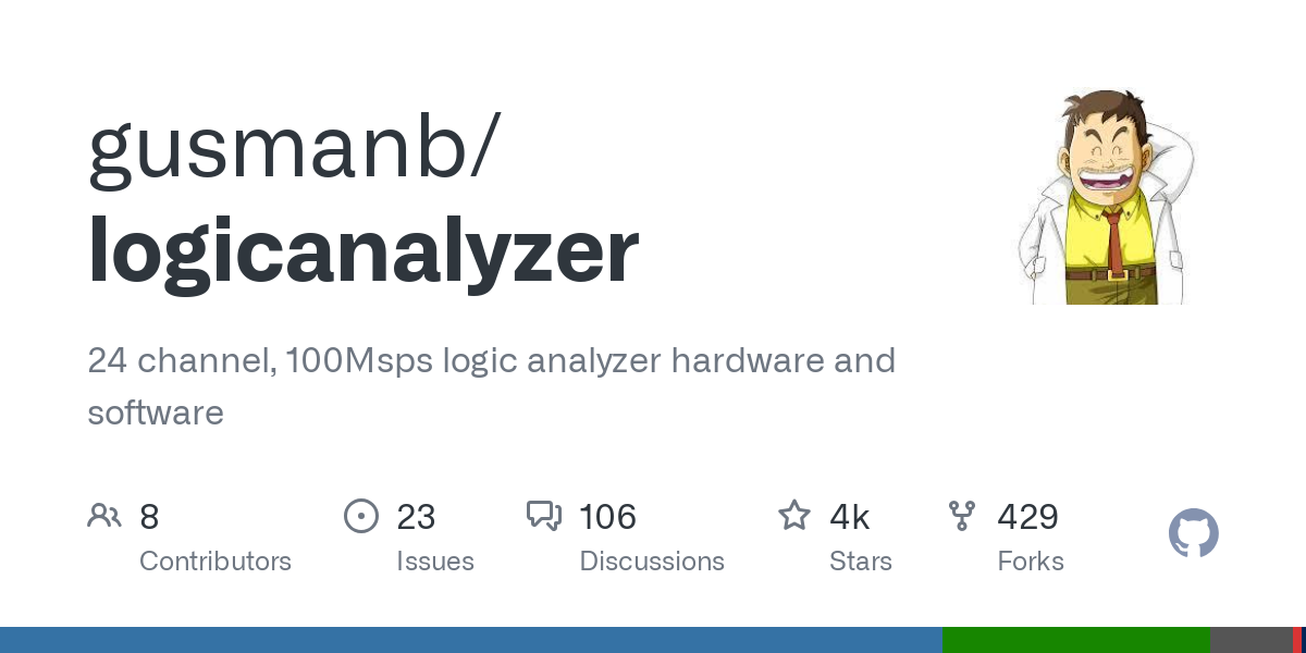

@mar0ni As you can see, Agustín Gimenez Bernad (gusmanb) managed to get a PICO2 with an RP2350 that has the E9 bug (and it’s not even a custom-designed board :laughing: — so no 100% impedance control + 100% symmetrical tracks) running at over 100 MHz (and beyond), and it works just fine.
Keep in mind that the Bus Pirate has buffers as a front-end, and you’ll be using cables, planks etc., so there’s really no need to worry about the RP2350’s limitations from the bug, pull-downs, or any of that.
In the specific case of the Bus Pirate v6, it doesn’t matter for general use.
Think about it — to do anything properly above 100 MHz, you already need to take signal integrity seriously… not use random unshielded Dupont wires :laughing:. So yeah, I don’t see any problem with buying it now.
I believe the full delay table for the RP2350 still isn’t public or complete — look at the one for the RP2040, for example… so there’s really no drama in buying a Bus Pirate v6 with the older RP2350, IMO.
