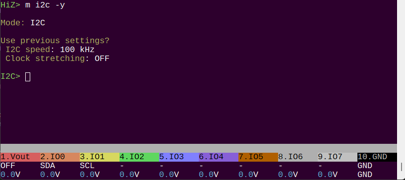

@rominos2 I added a hack to I2C only (awaiting full system wide solution) that should use saved parameters if you add the -y flag to the m command. I have not tested it because I’m swapping over my debug setup for tomorrow, but it should work. An autobuild should drop shortly.

Can confirm that this does work. I’m tempted to add it everywhere, but probably a better use to add long flags somehow to make modes fully configurable from the command line.
Yes it’s working good.
