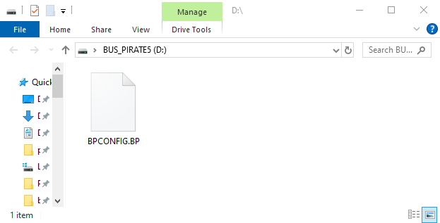

USB Flash Drive Use
Sharing the NAND chip between the Bus Pirate and a computer is a bit tricky. The USB mass storage driver doesn't have a mechanism to signal when changes are made to the disk, leading to data corruption. This is why e.g. Android uses MTP protocol for file transfer.
To keep the Bus Pirate and the computer happy, and prevent data corruption, we use a bit of trickery. This can seem odd if you don't expect it.
Read Only Mode
When a terminal is connected to the Bus Pirate, the flash storage appears as a read only disk to the computer.
  • Bus Pirate has read/write access to the disk
  • The computer can read files from the disk
  • The computer can't write to the disk
  • The disk with re-attach after file changes
Let's elaborate on the last point. When the Bus Pirate makes changes to the flash - say saving a configuration file or dumping a flash chip - the drive will detach from the PC and then re-attach. This is to ensure that the computer sees the updated contents.
The disk will detach and re-attach when the Bus Pirate writes to the disk.
Read/Write Mode
When a terminal is not connected, the flash storage appears as a read/write disk to the computer. You can copy and delete files as you would with any other USB flash drive.
To enable read/write mode, disconnect any terminals from the Bus Pirate serial ports.
