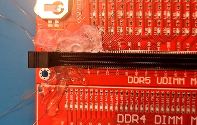

Just deployed some bodge wires, but for tapping not fixing :slight_smile:
had to depoly a few this weekend, too. Had a few JST plugs without pigtails (was unable to source the right ones quickly), bodgewire and a glob of hot glue to secure the plug end fixed it.
was for a quick interposer to sniff a few signals while doing some REing work

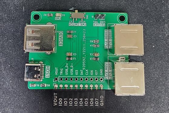

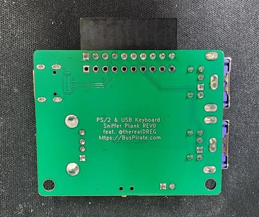

We have 5 assembled prototypes. One to @dreg, one to me, and we’ll put the other 3 in store.buspirate at cost of parts+assembly.

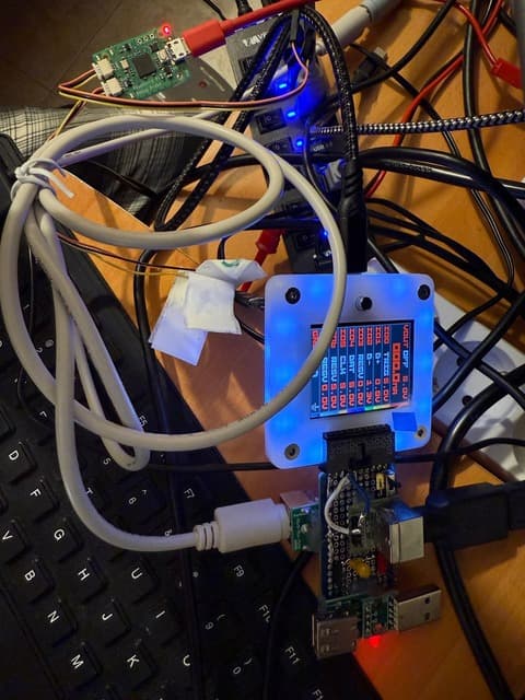

Soon I’ll make a PR with the functional POC firmwares to validate that the Plank is working properly, and then continue refining the firmware (for both PS2 and USB).
PS2 code working on my DIY Plank

PS/2 & USB sniffer plank (developers only).
If you want it grab it, I think there are <= 3 people who will buy a prototype. Please, take my excess protos :slight_smile:

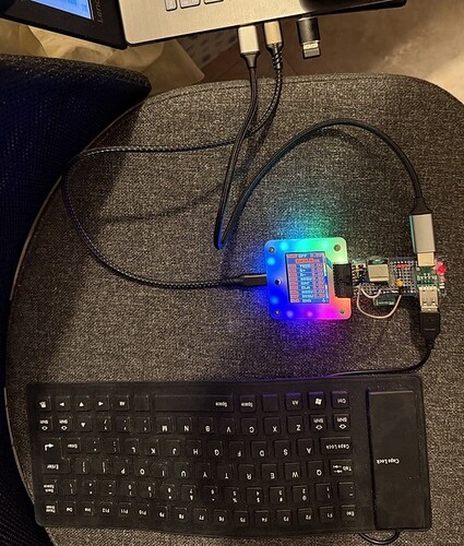

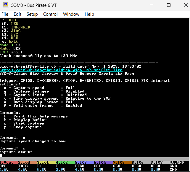

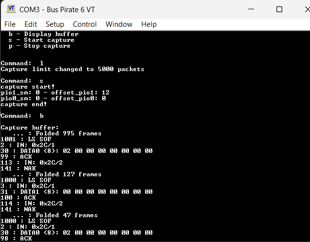

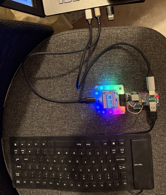

(keyboard low speed: pressing shift & release)
My DIY PLANK works perfectly (PS2 & USB). I’ll give you feedback on the official PLANK once it arrives at my place.
Ha! Good work. Also, that’s the exact flexible keyboard I used to make the PS2 demo for the v3.x bus pirate. I think mine was pink or purple, because I strongly believe hacker tools should be pink.
Basic functionality is done. I’ll keep improving everything as I get feedback from the community and other developers.
