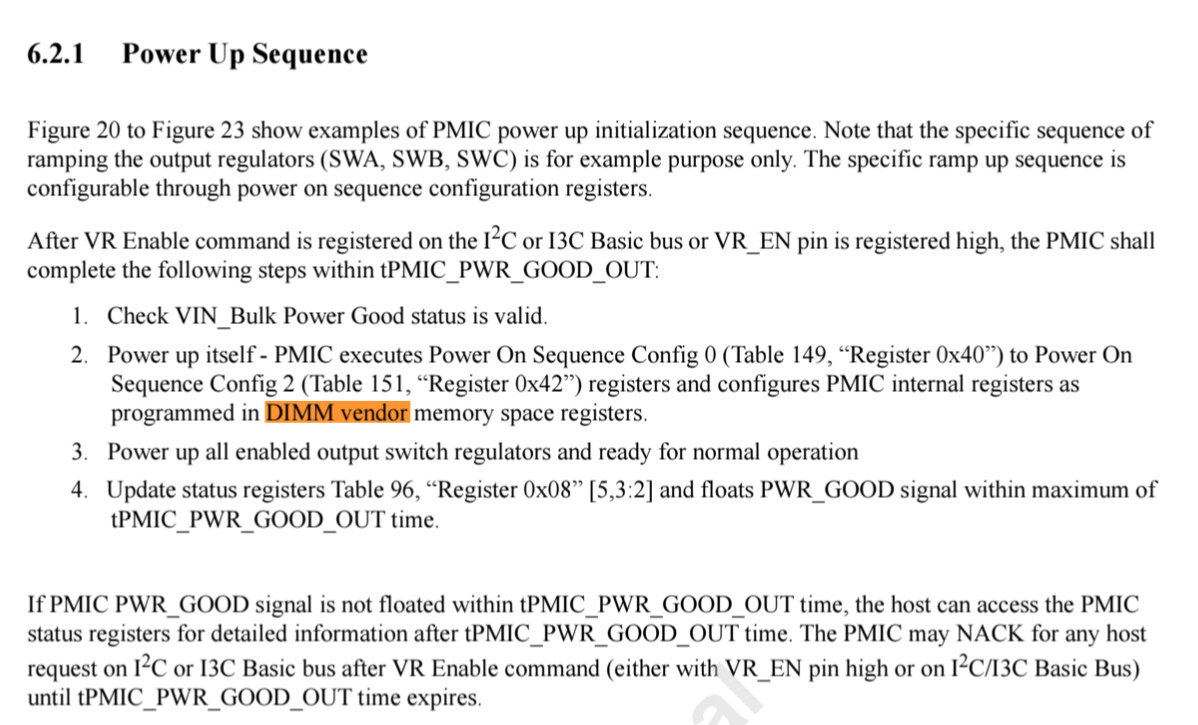

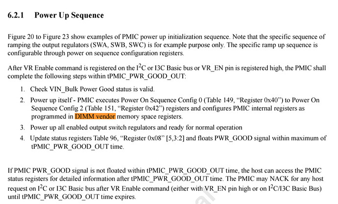

One possible avenue would be to alter the dimm vendor region registers for voltages/thresholds (yes, would be a pain from an ‘in the field’ perspective but ..). During the power up sequence, the dimm vendor region registers are copied over to the internal PMIC registers.
There is a default password for the dimm vendor region. From experience of other ICs, most will leave this password at default: “The default password for DIMM vendor register is 0x9473.”
As for the write protected stuff, it seems you are looking at PMIC5010 documentation. From my findings, most consumer level dimm/sodimm are using PMIC5100 standards (and the PNs on the dimms I have looked at all come back as such). This may be why I don’t see any reference to ‘CAMP’ (I have been using jedec PMIC5100 docs). It seems the method for disabling WP is much more straightforward on consumer dimms (from what I can see).
This still doesn’t change the fact that something is preventing host changes in programmable mode.
I am adding another photo (can’t add two since I’m a new user) below for the process of accessing/writing to dimm vendor region.
