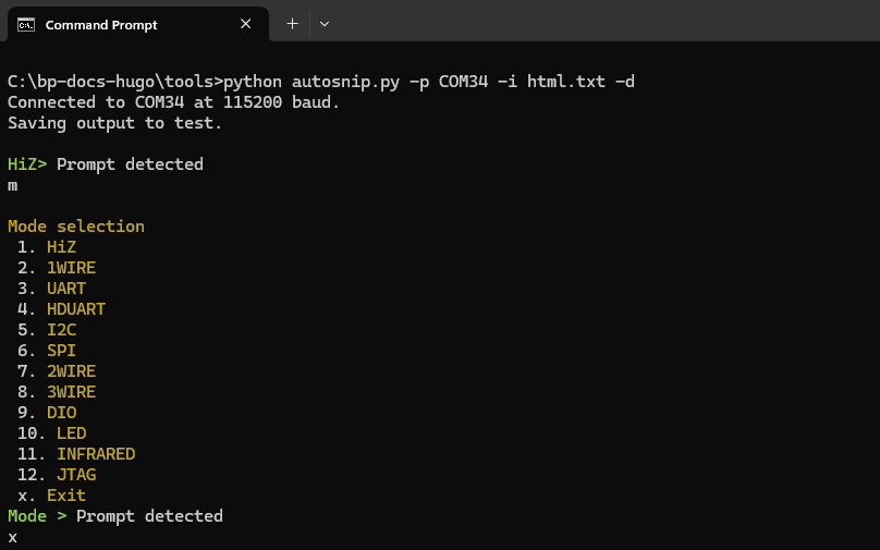

python autodoc.py -p COM34 -i demo.txt -f output.json -d
Detecting the various prompts proved to be a nightmare, sooooo… I added \x03 END OF TEXT (ETX) character to every prompt in the firmware. This is a non-printing character that shouldn’t mess with terminals, but it gives the automated docs/testing a way to spot the next prompt without “guessing”. It works great! (so far)

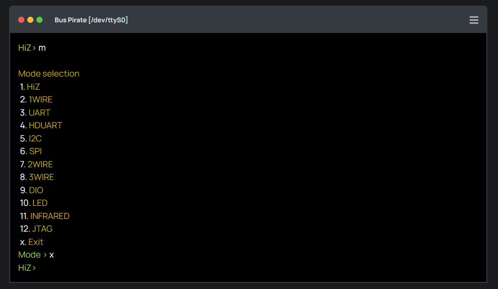

A second much simpler script to create output snippets for the docs. There is something weird going on with new line and reset line, seem to get multiples out the VT100 stream that shouldn’t be there.
I’m probably going to need to add some basic vt100 parsing. Just nuking all the 0x0ds seems risky.
With some questionable post processing, simple output looks fine.

Okay! Far from complete, but here is the new master command reference page. It includes everything: basic use, global commands, modes, bus commands, mode commands, etc.
It is fashioned after the PICO SDK docs, which are a single page that documents every function in the SDK. Next I’ll remove the individual protocol/mode pages, everything will be centralized. It took a while for this style of docs to grow on me, but here is what I like about it:
  • CTRL+F on a single page to find what you need
  • Print a single page to PDF or paper, less click click click
Most of the terminal output in the first 4-5 sections is now automated with autosnippets, so it can all be updated in about 20 seconds with the python script :slight_smile:
