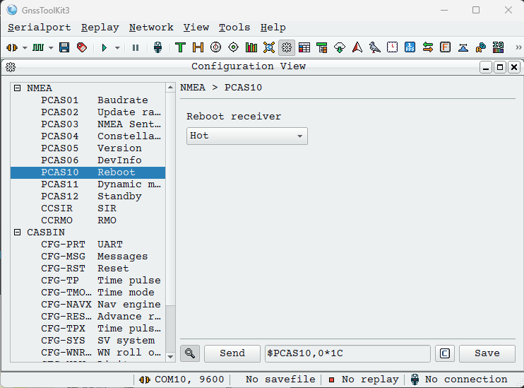

The GnssToolKit3 is a good reference to decoding NMEA and also configuring the gps module. This can be used through the Bus Pirate bridge command in UART mode.

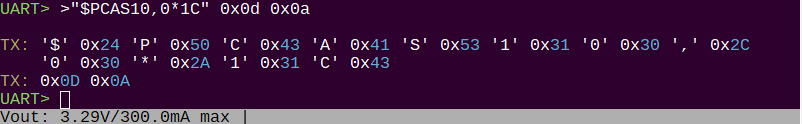

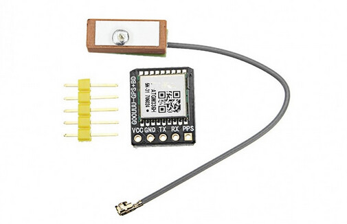

I have one of these, looks like an ATGM336H-5N-31-0, this appears to be the datasheet.
Description PCAS Command
save configuration $PCAS00*01
hot restart $PCAS10,0*1C
cold restart $PCAS10,2*1E >“$PCAS10,2*1E” 0x0d 0x0a
factory reset $PCAS10,3*1F >“$PCAS10,3*1F” 0x0d 0x0a
stationary mode $PCAS11,1*1C
GPS Only $PCAS04,1*18
BSD Only $PCAS04,2*1B
GPS+BDS $PCAS04,3*1A
GPS+GLONASS $PCAS04,5*1C
115200 Baud $PCAS01,5*19 >“$PCAS01,5*19” 0x0d 0x0a
0.2 Hz $PCAS02,5000*2A >“$PCAS02,5000*2A” 0x0d 0x0a
According to this page it accepts “$PCAS” instructions for configuring baud rate, sample speed and other stuff. I have not used these before, and searching around it seems uncommon.
I was able to hot reset and change the baud rate.

Trying the module with GnssToolKit

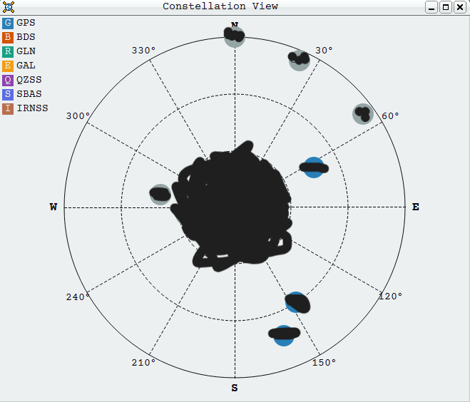

Out the window, after about 2 minutes, I get time and date info. Nice! 5.5m is probably not right, I am almost certainly ~2m below sea level on the ground floor here (according to the water level display at city hall).
When it gets a lock the constellation view is very cool. However, it only sees a few satellites compared to my phone (36!).

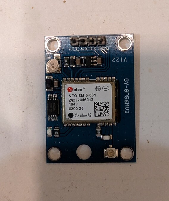

Interesting. That seems to be a major brand, with a proper website. The 6M is deprecated.
  • Neo-m9n appears to be the replacement. (~$15-20)
  • ZED-F9P adds RTK (real time kinetics) which increases accuracy to CM level. It is not clear to me if RTK is in the module, or requires UBLOX subscription/internet connection. A comment at sparkfun mentions pulling RTK data over mobile network, so I assume it is correction data written into the module? ($80-$90)
  • ZED-X20P seems to be the up and comer.
I was going for the most basic GPS at a cheap price point. I didn’t need GNSS or anything else, so I figured older was just fine. I was just looking to at GPS to my ALPR war driving setup (an ESP32S3).
Heck, maybe there were used and reclaimed - that would explain the pricing
Exactly what I did myself :slight_smile: Probably the cheapest “small” GPS I could find.

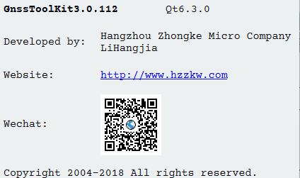

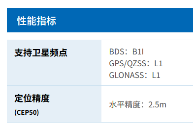

Noticed something interesting: my GPS is made by ZhongKe Microelectronics and so is the open source GnssToolKit.

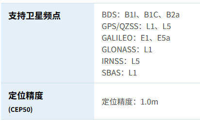

Here is the page for the GPS unit I have: ATGM336H-5N.
They seem to have a 332 (larger package) and 336 (small package) parts. ATGM336H-F8N76 seems to be the newest. I’d guess the -F8N means it is the equivalent of the ublox -M8P types. They seem to have similar models for ublox 5/6/7/8 and similar specs.
Modules with the -F8N76 are pretty rare, but available.
The big advantage -x9x vs -x8x is the ability to lock 4 different GNSS instead of just 2. That means that tracking satellites in GPS / QZSS, GLONASS, Galileo, BeiDou networks all at once. Curiously the ublox M8P does not support the EU galileo network.

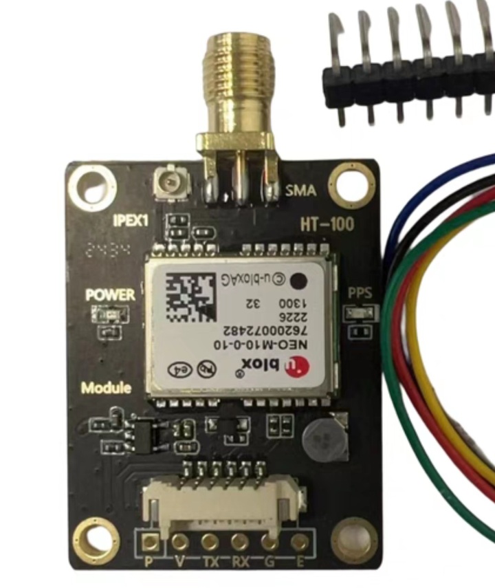

Bought the ublox and other GPS module.

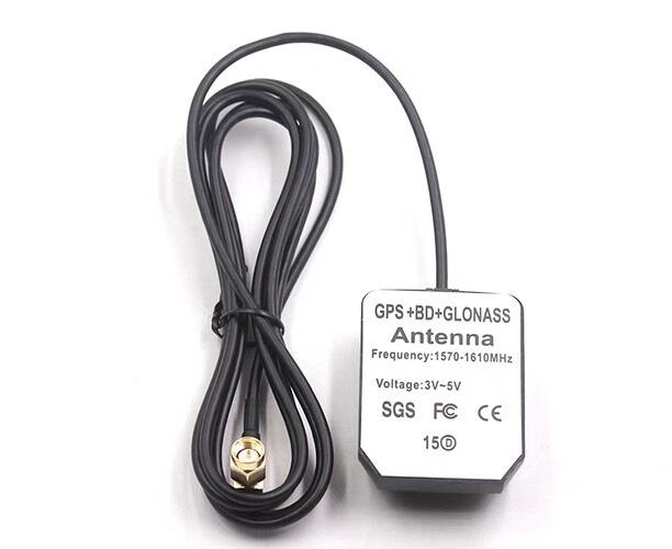

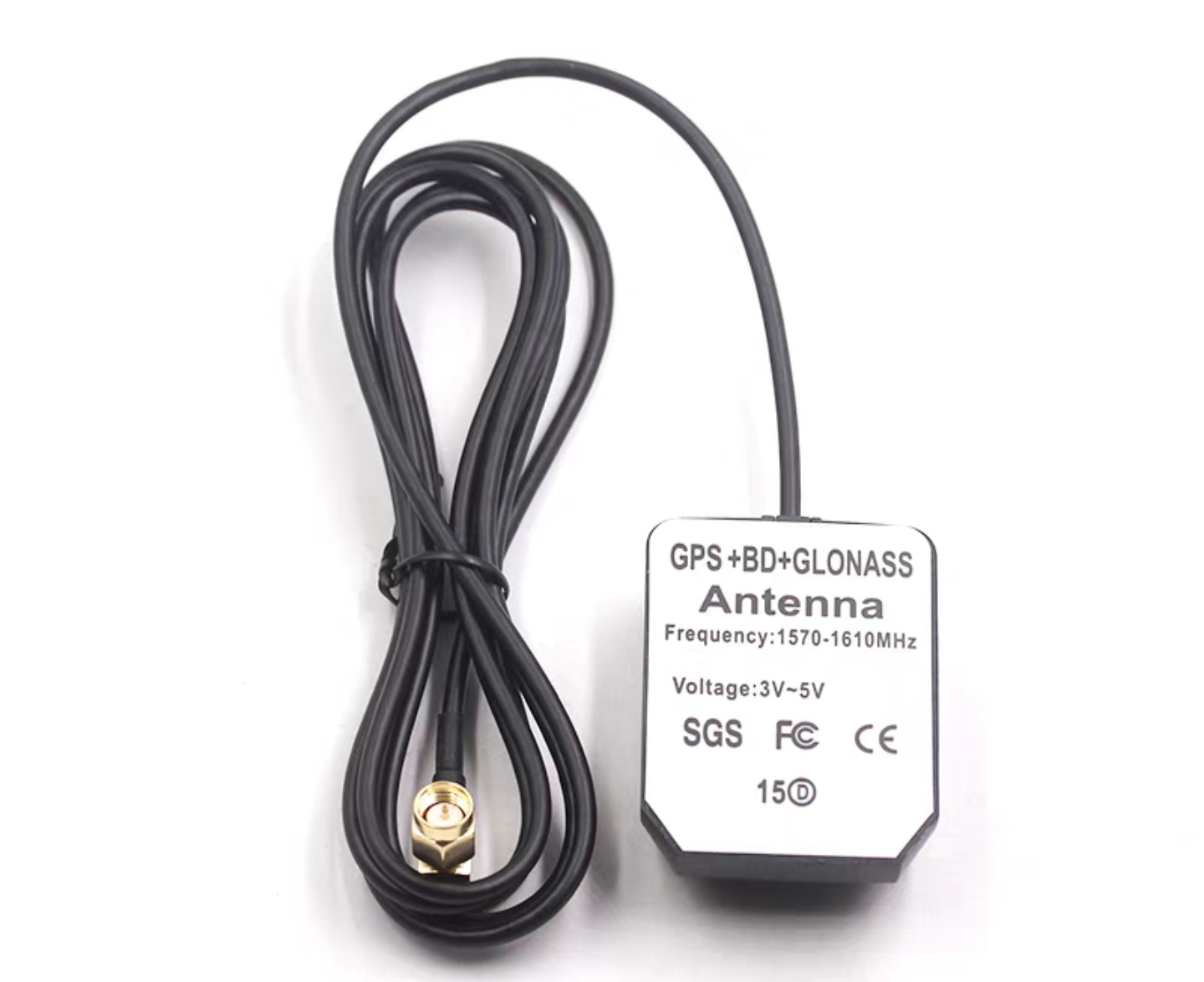

Got a few different antennas as well. Hopefully this can go in the window and connect to a module on my bench.
I bought a GPS specific antenna, one for GPS plus BD (Chinese system on different band), one for GPS, BD and GLONAAS. Curious if they’re actually better tuned for the different frequencies.

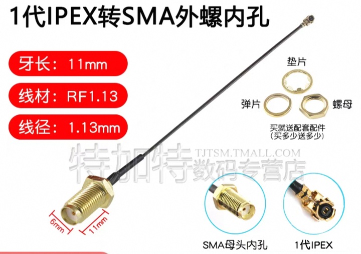

Finally, a SMA to IPEX adapter to use the antennas with my existing non SMA modules.

Well, that looks a lot better
HiZ> m uart
Mode: UART
Use previous settings?
 UART speed: 9600 baud
 Data bits: 8
 Parity: None
 Stop bits: 1
 Hardware flow control: None
 Signal inversion: Non-inverted (Standard)
y/n, x to exit (Y) >
Actual speed: 9600 baud
UART> W 3.3
3.30V requested, closest value: 3.30V
300.0mA requested, closest value: 300.0mA
Power supply:Enabled
Vreg output: 3.3V, Vref/Vout pin: 3.3V, Current: 26.1mA
UART> gps
Press any key to exit
$GPTXT,01,01,02,u-blox ag - ww,99.99*30
$xxxxx sentence is not valid
$GPGLL,,,,,,V,N*64
$xxxxx sentence is not parsed
$GPRMC,,V,,,,,,,,,,N*53
$xxRMC: raw coordinates and speed: (0/0,0/0) 0/0
$xxRMC fixed-point coordinates and speed scaled to three decimal places: (0,0) 0
$xxRMC floating point degree coordinates and speed: (nan,nan) nan
$GPVTG,,,,,,,,,N*30
$xxVTG: true track degrees = nan
        magnetic track degrees = nan
        speed knots = nan
        speed kph = nan
$GPGGA,,,,,,0,00,99.99,,,,,,*48
$xxGGA: fix quality: 0
I can work with this :slight_smile:
Excellent! Is this one of the new modules?
Yes. Still an older model, but at least it works!
