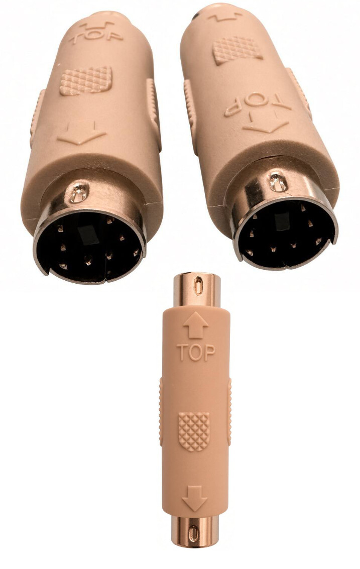

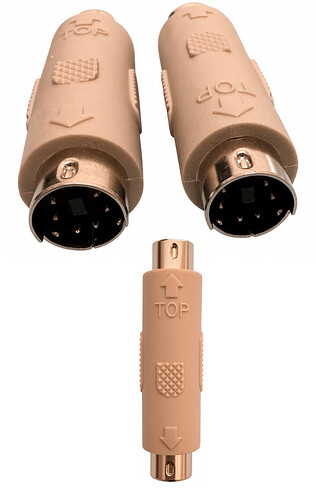

PS2 male to PS2 male adapter (MINI-DIN 6P)
Instead of a PS/2 male-to-male cable, you can use a PS/2 male-to-male adapter, which is shorter and easier to work with.
I have only found it for sale at one place, but I find it really handy.

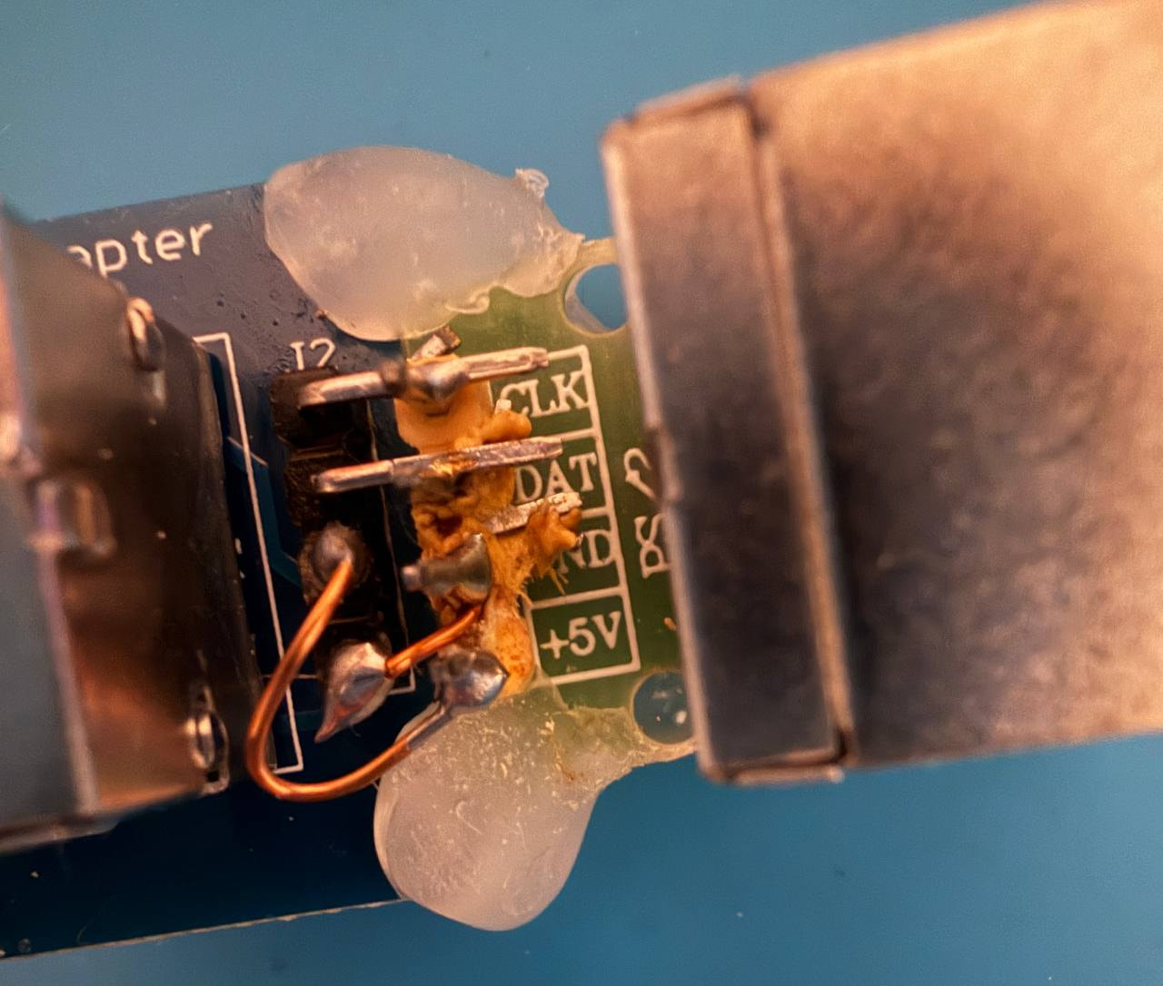

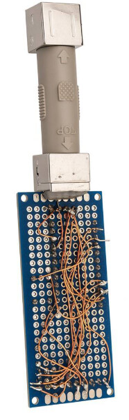

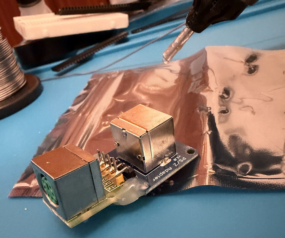

Since there was no stock of PS/2 female-to-female adapters, I made this one myself. I also left the pins exposed like this so I can easily hook it up to a logic analyzer.
Nice hack with the header soldering :slight_smile:
I’m an idiot, haha, these adapters didn’t have VCC and GND in the same spot… fixed now!

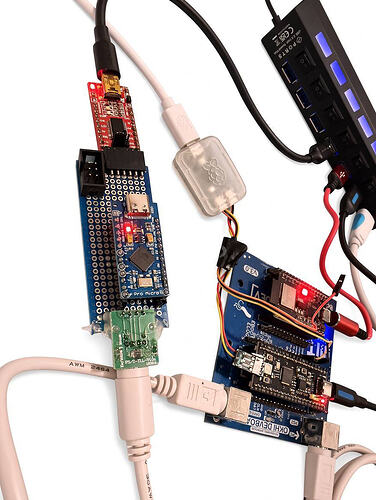

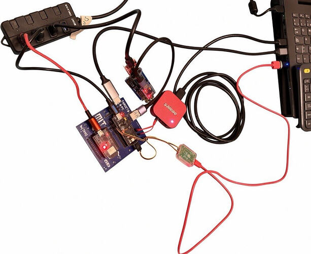

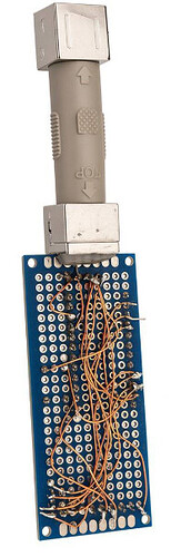

Auto Testing PS2 with Pro Micro DIY BOARD

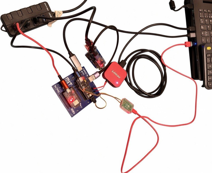

Auto Testing USB with Pro Micro DIY BOARD
whats that board to the left of the saleae?
My development board that does roughly the same thing as the Bus Pirate PLANK, but with additional features… Wi-Fi-enabled keylogger, etc.

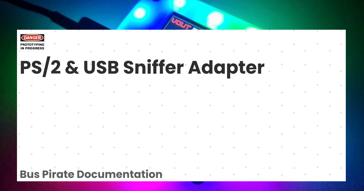

Docs merged and updated. Split the PS/2 & USB Keyboard sniffer into two pages:
This should be the hardware

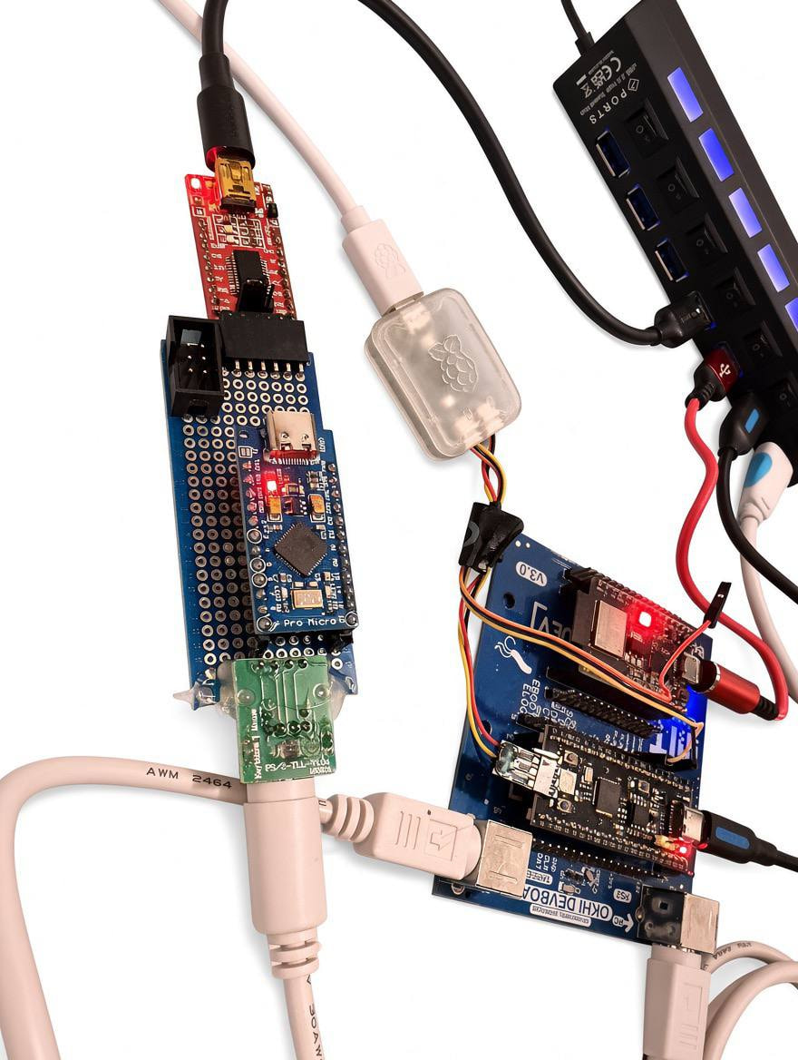

Fixing ps2 & usb firmware bugs…
The setup is crazy :joy:
