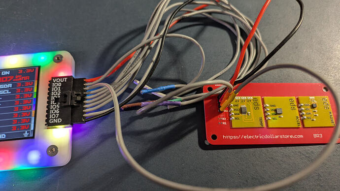

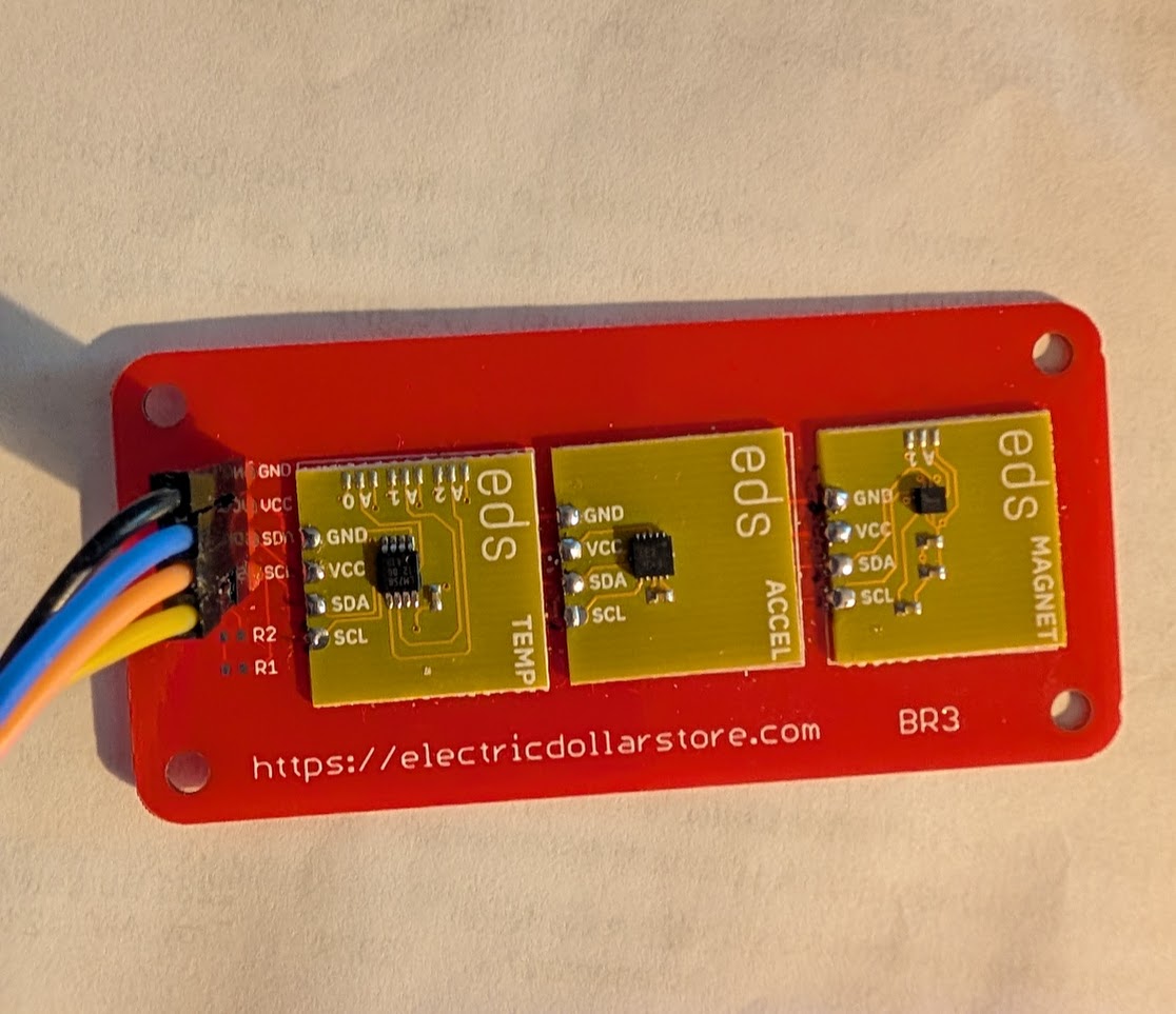

The 3 additional sensors are on a dedicated breakout board - I wanted a reliable setup for testing.
Thank you so much for the Saleae captures and additional info. I’ll start by testing BP6, but with the holiday and CCC it may be a bit intermittent.
I saw your Electric Dollar Store target devices in the image above. Interesting looking stuff, so I just ordered some to try.
I’ll be able to add another set of data points for this; I have a BP 5 and a six, so I can give it a try too. Been meaning to try the Python BPIO2 interface :slightly_smiling_face:
Take your time, Ian. I felt guilty for documenting this right before the holidays.
I used the Electric Dollar Store because I wanted a reliable test setup. I really dislike breadboards, which is why I use Cybergibbons reverse breadboard for the setup (headers on stripboard), to make a reliable connections.

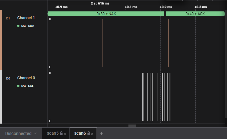

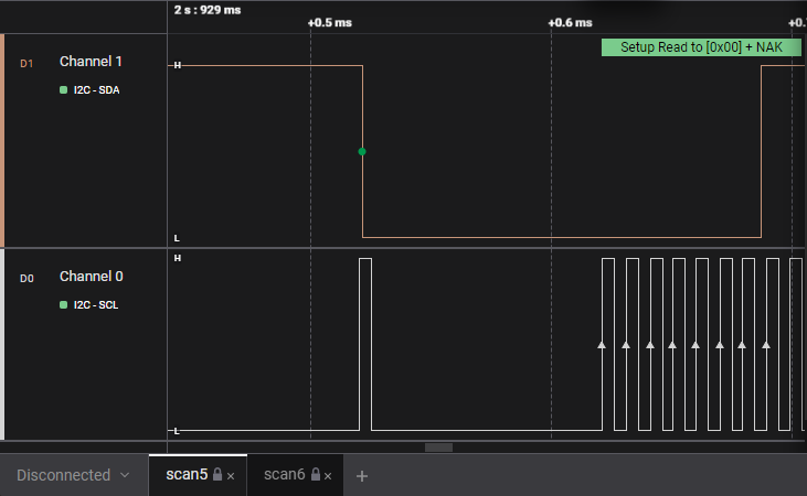

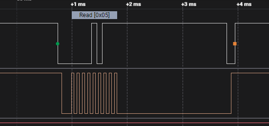

The capture of BP5 output looks good.
And this seems to be the issue with BP6. The start condition timing is off.
You can see here data falls way before the clock is high, this isn’t a valid start or stop.
Now, why it is off, and only 6 in BPIO mode, remains a mystery to solve tomorrow :slight_smile:

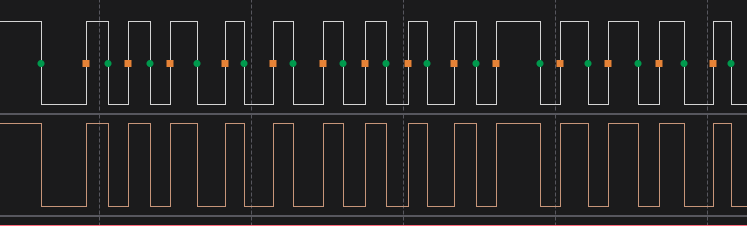

Fixed a bug and a debug display error in I2C:
  • Fixed spurious read when readbytes = 0
  • Fixed debug shows I2C start when one wasn’t requested (no actual impact beyond incorrect display).
Now we get nice starts and stops on 5 & 6 (6 shown above).
Not sure this will fix the scan issue, but making some progress.
There we go. Fixed scan on BP6/I2C.
