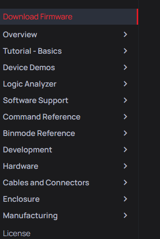

This is the current order of the table of contents. I put “download firmware” at the top.

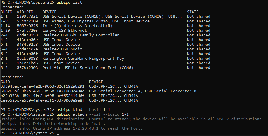

What problems are you having with WSL? I’ve used my Tigard in WSL using USB passthrough Connect USB devices | Microsoft Learn
I just did this maybe 2 months ago, so things shouldn’t have changed too much. From what I remember you just install GitHub - dorssel/usbipd-win: Windows software for sharing locally connected USB devices to other machines, including Hyper-V guests and WSL 2. then use usbipd list to get your USB device list, then usbipd bind --busid <ID from list> and lastly usbipd attach --wsl --busid <ID from list> I’ll give this a try tonight.

In windows to attach the BP:

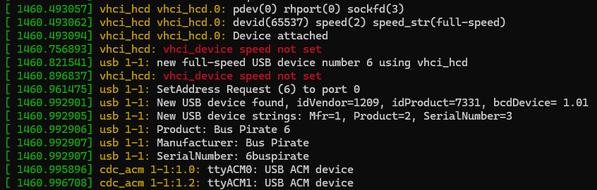

dmesg from Ubuntu WSL:

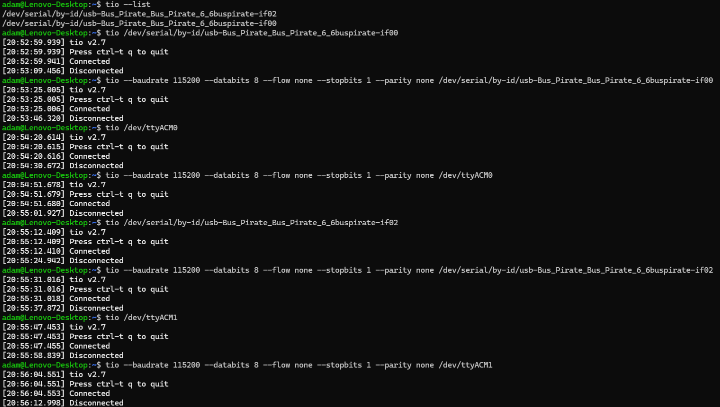

Output from tio:
Is this what you are getting too?
